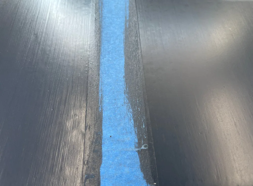

Take a look at the two samples below. In the first image, we can see how the retarder added into the EM9300 Polycarbonate Urethane on the right side produced a more level and smooth finish vs. the left side.
Wood Finishing in Warm Weather: How to achieve a more level finish
Warm temperature test #1 (urethane): left side is finish alone. Right side is the finish with SA5 Retarder added.
